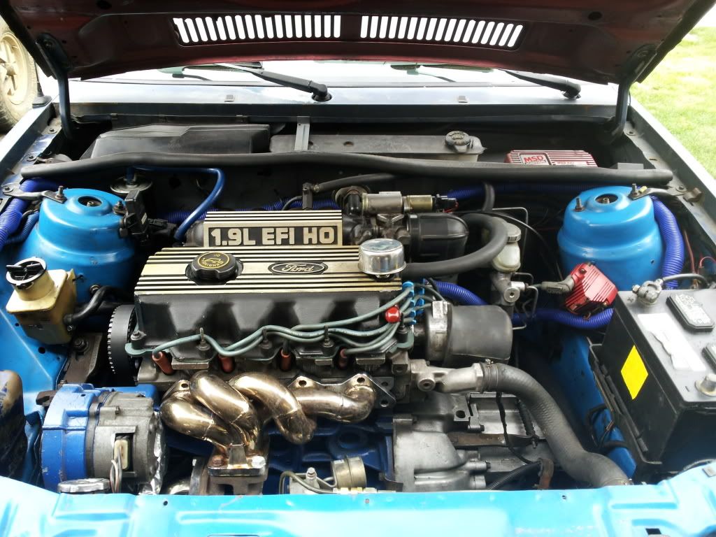

heres a picture of my setup since i never posted it in here.
Mitsubishi TD05H 14B turbo
Custom manifold and flanges
1st gen DSM BOV venting to atmosphere
28.5" x 7" x 2.5" FMIC
Bosch 42# injectors (green giants)
4.6 Cobra MAF (blow through setup)
3.8 Throttle body
Civic radiator
Custom solid motor mounts
Hallman Pro Rx boost controller
Custom upper alternator bracket
Auto Meter oil pressure & boost pressure gauges
AEM wideband
See less See more

Just got the Turbo back on, new manifold, 3" downpipe, bigger t25 turbo over my old IHI. 1.9L on 18psi.. spools around 2200 trying to figure out best injector size.. going to start with some 42lb and tune it with those, any suggestions?
