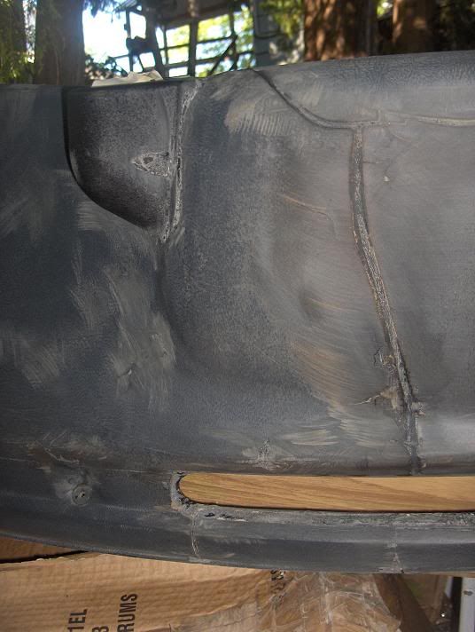

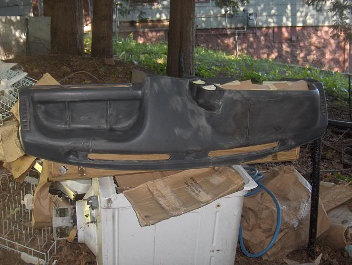

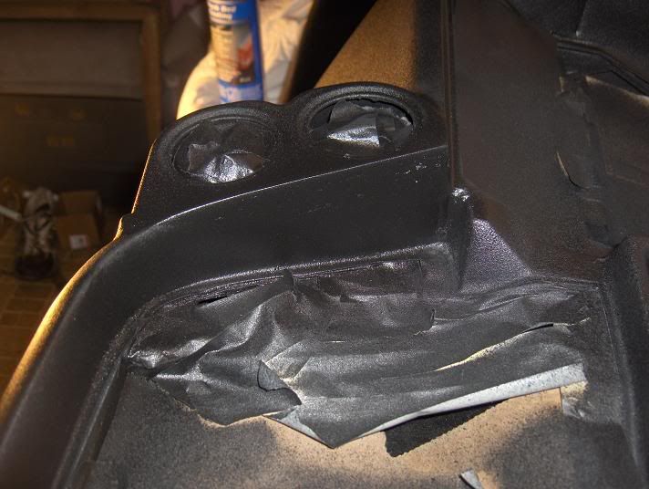

1. Sand all the cracks flat to the dash, you want the sides of the cracks to curve into the crack so when the adhesive is laid it has a smooth transition between the filler and original dash [something I didn't do too well on :p]. The sanding wheel with will get the job done but be careful with dry dash for chipping [WEAR SAFETY GLASSES!].

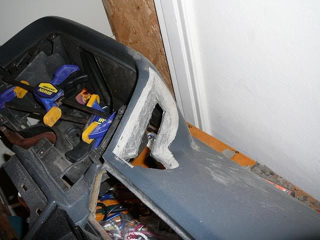

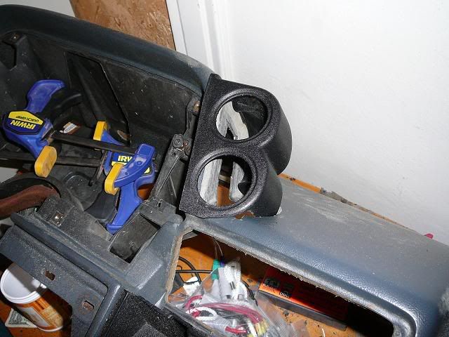

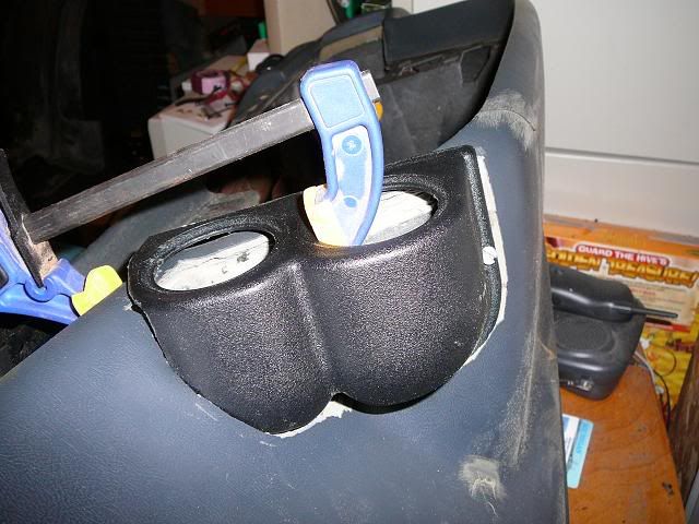

1.5 If your planning on just repairing, skip these half steps. Otherwise, get a pod of your choosing and figure where you want to mount it [I chose to the side of the instrument cluster]. I had to dremel the pod to fit on its side.
Cut a small hole right through the dash in you choosing spot and gradually work the hole wider to seat the pod to the polymer under layer.
Work a hole that goes to the sides of where the pod is for cords and easier working.
2. Wipe down the dash with some Windex, this cuts through any dirt and grease on the dash, and it's common to find under the sink.
2.5 I applied a plastic Epoxy on the inside of the pod to the polymer dash to better secure it without much help of screws. I drilled a prep hole put one on the top to keep it steady on the dash and so I could use the clamp to keep the pod where I wanted it till the epoxy cured. Leave the screw and grind down the head with the dremel, it will get covered later.
3. Prep the Adhesive to apply to the cracks. Small cracks just starting should cover well with the bed liner later in the procedure, but if you can get the adhesive in the crack by slightly bending the dash do so.
The kit only has two nozzles so if your looking to repair anything else with the stuff prep it as well. The stuff should have the viscosity of molasses. Don't start applying until it reaches this state or it won't cure to the dash. Make sure to over apply to the cracks for sanding down [More then what is pictured :p].
3.5 The adhesive for joining the pod was a real pain where I wanted to mount it. I used the pieces I chipped off the pod to get it to fix for a wall for the adhesive to build up on. This must be applied in steps, otherwise it won't stay in the void you are trying to fill.

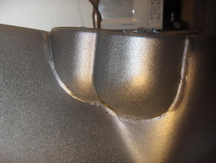

4. After about an hour, start GRADUALLY step sanding the adhesive. You can use the sanding wheel up to 120 grit, after that do it by hand with a sanding block or a piece of wood. If you can feel the transition between the filler and the dash it will show after paint is applied.
4.5 You can use the dremel to sand the adhesive down to give it a rounded seam into the pod to better hide your handy work.

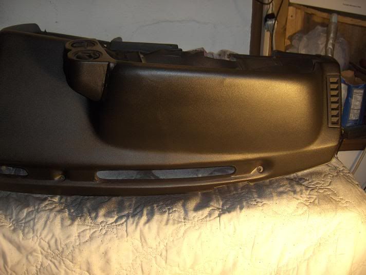

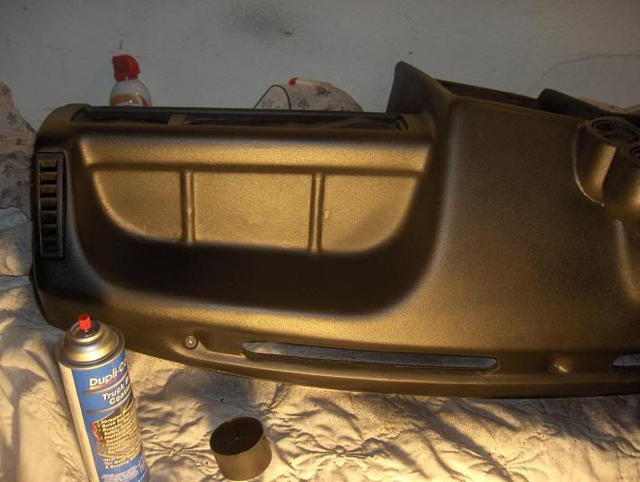

5. If desired, lightly sand down the whole dash, by hand, with 120 grit or finer so the paint will stick better to the dash. Two layers of paint should cover the general dash. Any small imperfections can be covered with the bed liner, Just remember to follow the cans instructions for cure time between layers, sand lightly between layers.
6. Apply a light truck bed layer to match any areas that you have sanded to match the rest. Apply the interior paint to the dash with a minimum of 2 layers, touch up where needed.
7. After a short cure time, I very lightly applied a speckled layer of truck bed liner for texture and color scheme.

All of the materials should work together. The urethane is made for bumper repair, the bed liner is a vinyl polymer [same material as the dash] and it is made to be painted onto. Everything is made to work with one another. However, if it does start to peel or any other defects I'll be sure to post.

The top of the dash had too much sun damage to the plastic, just the slightest pressure on the surface caused the material to crack. I stripped off the plastic & started a new method, I'll post later on if it works.
