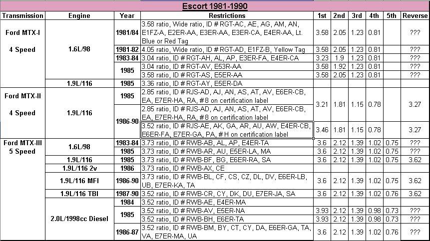

I was hunting down some info on gear ratio's trying to find what gears are different if any one a GT vs CFI trans. When I was doing the digging I found that the Diesel trans is geared rather high, likely for the for the lower HP motor. Then I got to thinking, a GT diff is 3.72 and a CFI/Diesel is 3.53. the first gear in a early Diesel trans is 3.92 vs 3.6 in a GT trans. Wuld a GT diff/finale gear fit a Diesel trans? If i'm not gettign my gear ratio stuff mixed wouldn't that make the car start off the line a lot faster?
3,216 Posts
Without having experience with the first gens, I will guess "yes", but those diesel transmissions are going to be pretty hard to find!
Also note that only the 1985 diesel transmission first gear ratio is listed as 3.93, the other years being 3.6, or unlisted.
286 Posts
I would assume any MTX-III internals are swappable, but I don’t have a definitive yes or no. Like Joey said, good luck in finding a diesel trans!
The pinion gear looks like it’s part of the driven shaft which would require stripping down and restacking the whole shaft. It may end up being easier to swap the first gear set, if that’s even possible.
326 Posts
I've heard of someone doing this to their diesel but it is a lot of work, like Shorty said you have to restack the output shaft for the new diff. Fair warning it's going to make your rpms higher in top gear resulting in worse fuel economy while cruising, you also need a speedo gear matching the new final drive for your speedometer.

Sho transmission would require custom axles. Not sure what else it would need.
But I thought higher gears ratio accelerated faster? Witch is why so many put 4+ rear ends in drag car? So I want the lower raito diff from the CFI trans?
the cfi I have is about 140-150is if I remember right. The car hasn’t been driven in a wile and it was last dynoed years ago.
But its had anything and everything done to it, tuned exhaust, roller head, milled head, high compression pistons, stroked, big cam, custom ECU mapping, board 2.3l TB with red injector, ported head, bigger valves, lighten drive train and much more. Had to run 95oct with octane booster just to get it to run right.
The HO will have a lot more done to it. HOs are what, 20ish more hp stock? It would probably be in the ball park of 175hp. But that’s just guesstimate.
326 Posts
Not the whole SHO trans, that won't work at all, just the differential from it
I don't quite follow what you have for a transmission vs what you want out of it, yeah a 3.73 will generally accelerate faster than a 3.52 and a 4.05 will accelerate even better - again that's only on paper, like I mentioned in the last comment going to extremes may kill your lap time if you spend too much time between gears.
